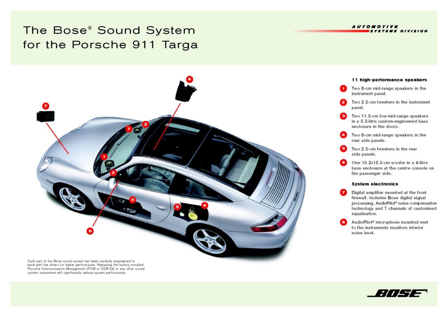

Could you let me know if the speakers behind the rear seats are speakers or a sub.
Her's the layout for a 996 Targa - coupe should be the same I would have thought.
Thanks for that.

Pace I'm not sure which model you have, but I believe Richard has kindly posted the Targa Bose set up, which is (if I'm right) as per the cabriolet. For the coupe/Turbo etc the sub woofer is mounted in the rear parcel shelf (not in the front footwell as per cab ) with outlets behind the rear seats!
Hope this helps.

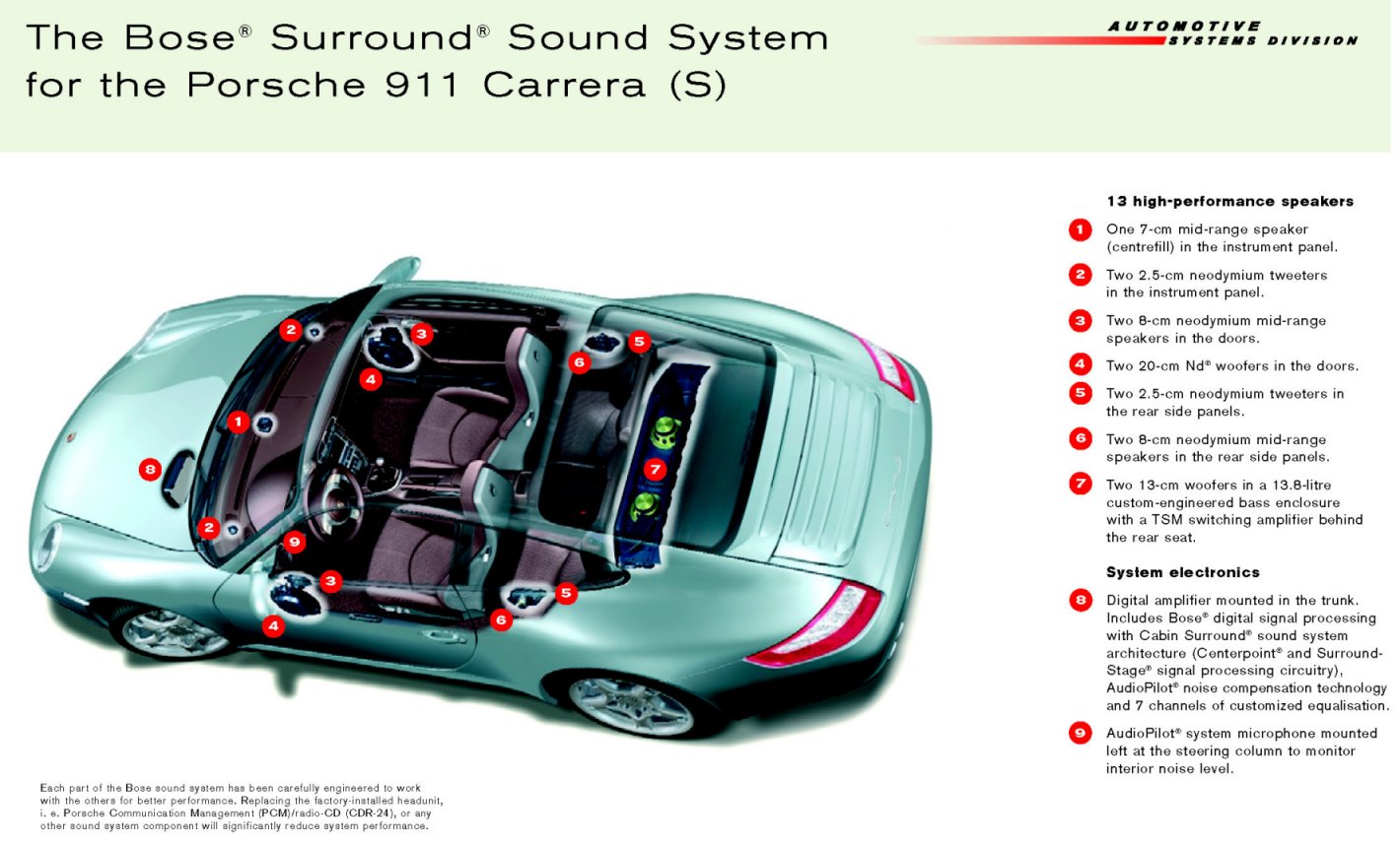

I stand corrected, thanks Grant. I wonder why that is though. The drive mechanism for the roof is behind the rearmost panel, so I assumed there was the same space behind the seats. I presume the Bose sytem for the coupe is similar to the 997 then, with 13cm woofers behind the seats:
