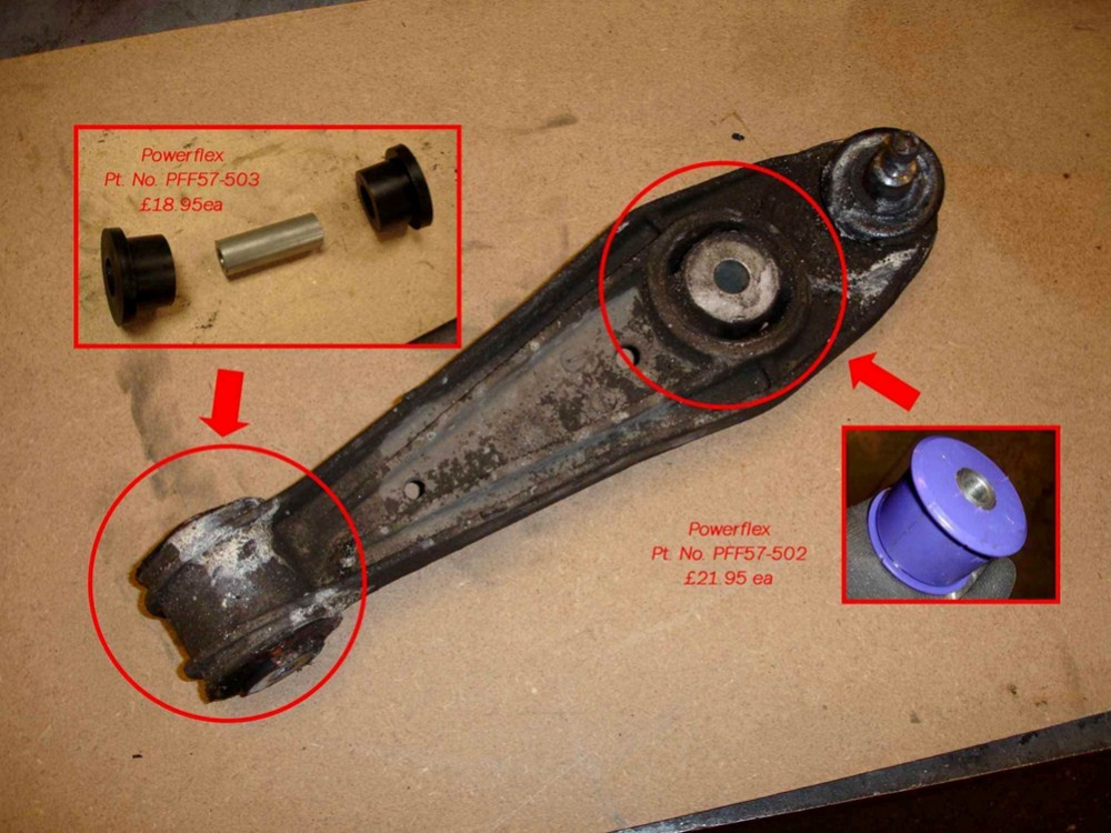

After reading your replies, I decided to take your advice and replace the track control arms as both were squeeking and driving me mad!
Upon checking, I decided this was indeed a simple job, one that I felt happy to take on myself.
After lifting the car and removing the wheels, it is simply a case of removing two retaining bolts, ball joint nut, and cracking the taper ball joint from the knuckle. Cracking the ball joint is by far the hardest part of removing the track control arm, and care should be taken not to damage the boot of the ball joint whilst removing (Reason will be clear later)
With the arm removed,upon inspection, it seemed that there was nothing wrong with the taper ball joint! However, the same could not be said for the two bushes. My car has just passeed 40K miles, and I would not expect the bushes to be in the state that they were.
Looking on the web, I found a site http://www.powerflex.co.uk offering uprated replacement bushes for approximately £40 per side. This seemed to be worth a try, so I contacted some distributers to confirm prices and delivery. I only wanted to change one side to start with in order to confirm if it was the bushes causing the problem or not.
I found that some suppliers were not prepared to sell just one of each of the two bushes, they insisted on selling 4 of each (enough to replace all 4 track control arms). However, as luck would have it, my local distributer ((Peter LLoyd Rally) http://www.peterlloydrallying.co.uk/ ) would basicaly supply what ever I wanted, and also offered very good prices.
Removing the old bushes is not the simplest of tasks, but with a little effort they will come out. (For help on removing the old bushes, look on ebay, search for 'boxster suspension bushes', this will return one result (Larkspeed performance and styling). Read through their ad. This should be help enough!
Fitting the new bushes is really easy. They can simply be pushed into position. A mallet may help with this stage though!!
To refit the arm to the car, first remove the plastic bottom pan. Secure the ball joint and outer bush first, then fit the inner bush last. I used a hydraulic car jack to position the bush in line with the bolt holes.
This turned out to fix the problem on the side I changed, so obvoiosly I repeated for the other side. Again, this fixed the squeeks.

Well done Mike, this concurs with what I found on my control arms. The diagonal arm bush(on the lower control arm) delaminates and causes the squeaks. The bush is designed to yeald in one direction and has "cut outs" in it. This makes it weak to start with. I found gravel stuck in mine. The powerflex bushes are a good move as they don't have the "cut outs" and will be stronger, of course you will loose some compliance but that will only sharpen the handling.
