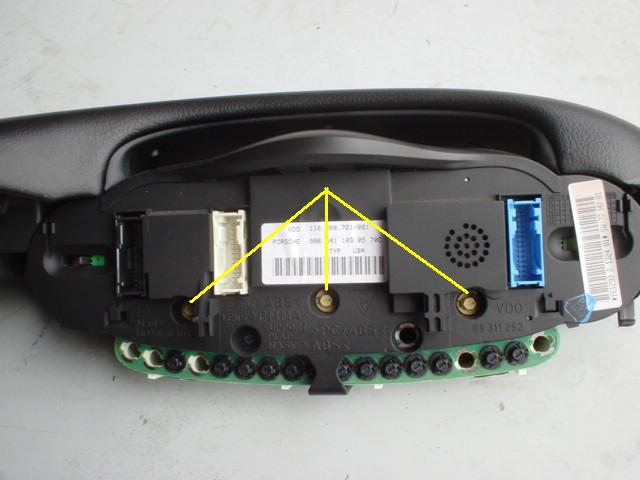

Each of the 3 LCD displays has it's own bulb. But you have to remove the instument cluster to replace it as it is in the back of the cluster.

Pry off the the button for the emergency blinkers and the round cell phone grill and behind each you will see a T20 screw that you remove. Then lift the entire cluster up. It will make a lot of noise like you are breaking something - that is just the clips that hold it down releasing. Then put a towel under it so the clips will not damage your dash.
The cluster has 3 size bulbs. The LCD uses 1.5 watts and has a tan holder. There is a yellow line to each of the LCD bulbs.
