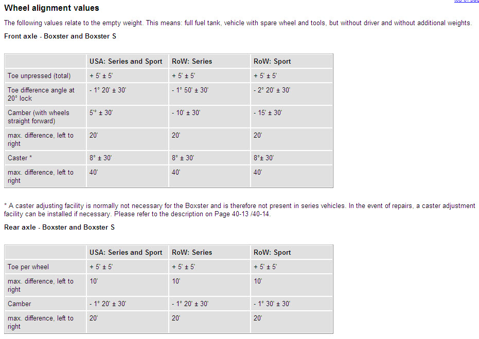

Can anyone tell me where I can find the Standard settings for my Boxster S, 2000 model.
Also any advice on Track settings?

17 or 18" wheels and standard or sport suspension ?
Full-on track settings are difficult on a 986 because you run out of top mount adjustment, so you have to settle for a bit of a compromise. You're not thinking of setting it up yourself, are you...?

17"" wheels, standard suspension.
Alan.
ORIGINAL: spyderman
Chris.
The plan is to take it for a 4 wheel alignment check, adjust to standard settings and see how I find it.
I'm doing Croft on 21st, after I see how it goes I may take it to Kenny Brown Motorsport to have it tweaked a bit more for track.
Alan.
Don't pay twice then, just take the toe out the front and have about -1.2 camber at the front, keep rear as is.
And see how you go from there.
Here you go:
