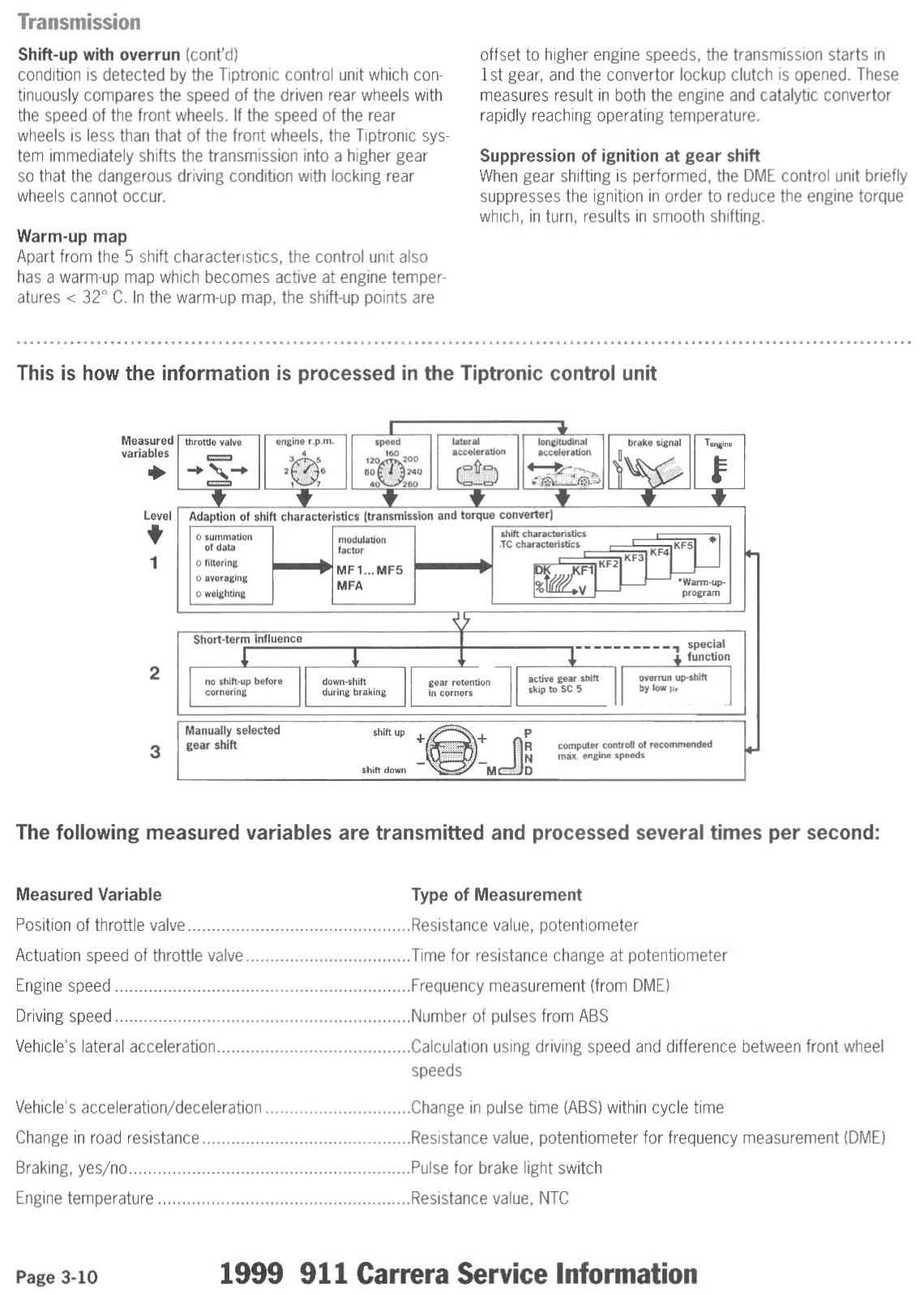

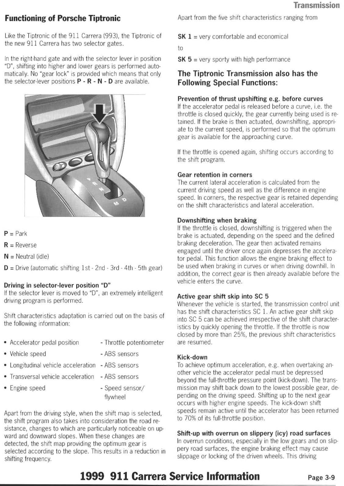

Here's the description from the 996 Service Information book.
Page 1:
Thanks for the feedback. Still not sure what is causing problem. Been reading the manual and wondering if it is the mapping for the kick down gear change. Going to try the tiptronic and see if car automatically shifts up gear when revs taken up 2 max - if this doesn't happen then I was thinking it may be related to whatever controls the systems gear change up when max revs are reached ??
