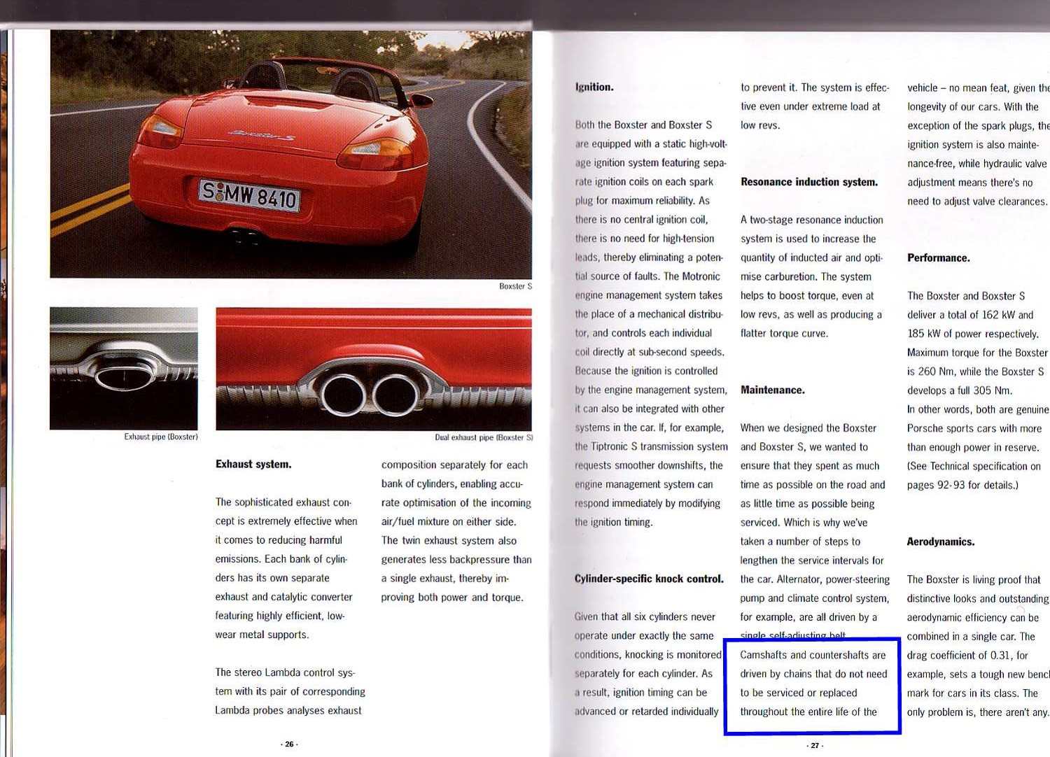

Eeer guys, if we are talking about what I know as the timing device, IE the part that drives the cams then its a chain. Do you see 'check timing belt' in the service history?
the power steering, AC ect are driven by a belt but the cams and variocam are driven by a chain.
Check the attached jpeg from the Porsche sales brochure for details.
I did ask in my first post if this is what was meant - however I did not realise the main belt has nothing to do with the crankshaft/cam timing.
Looking at the workshop manual again this is quite clear. The Porsche design is more radical than I realised!
So I was wrong - if this is what he meant. Sorry[&o]
