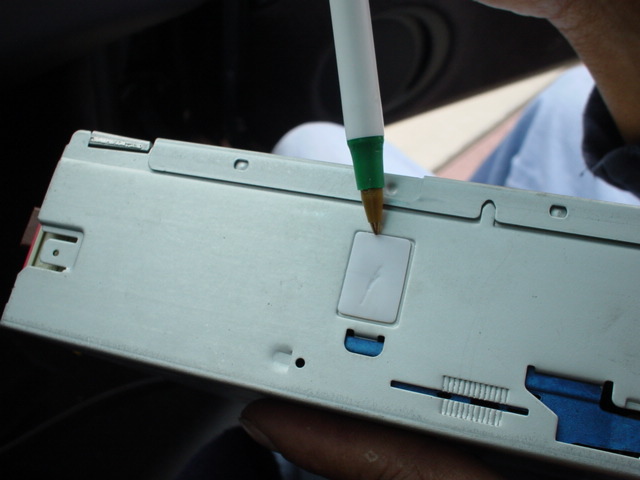

As you say, the radio also has a sensor - this is actually a piece of plastic that prevents a contact from "making" with the radio body. If it does it assumes the radio is being stolen and so the alarm...
The cure is to put a piece of tape on the radio body in the appropriate place.

this is what i mean. i get a single beep on the car when i lock. and sometimes the alarma goes on as well after an hour or so....how can i find this spot of the radio ? and also what are the door ajar ?

The factory 22 radio has a plastic insulator on the side for the alarm contact. Aftermarket radios do not have this insulator so you get a single beep when you set the alarm to warn you that the radio is not protected. You can mimic this insulator with a piece of tape on the side of the aftermarket radio.

mine is an s model of 2002!!!i checked the original stereo system and you won't believe it !!! the plastic was missing !!!! so i had to unistall my new 2 din radio (quite difficult !!!) and checked while being in the car what would happen when i would attach a plastic on a iron little thing i found !!! the alarm didn't make that annoying beep anymore !!!!!!!!!!!!!!!!!! :))))))))))))) and when i realeased the plastic thing the alrm went on !(not just a beep) !!! THANK YOU GUYS !!!!! i have had this problem quite a long time now !!!! i really apreciate your help. and good thing others found a solution as well :) !!!!!!!!!!!

Rather than insulating the alarm contact you could have disconnected the wire to the alarm contact,and then tape the end of the wire so it cannot ground to the car.
