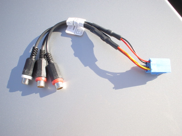

You have the 23 radio used 2003-2004. 1999-2002 had the 22 radio. With the 22 you could buy a Becker aux-in adapter that plugs into an empty space in the back of the radio (if a cd changer was not already hooked up to the back) and operate an MP3 player via the adapter. A picture of this adapter is below. With the 22 you would program the radio for aux-in and then the adapter would work.
There are 2 versions of the 23 radio. With and without an external amp. With the external amp means that you have Bose and thus the external amp is in the front boot. In this situation if you plug in the Becker adapter it will not work. But then I seem to remember Becker/Porsche came up with some type of solution.
Your 23 has the internal amp. I do not know what would happen if you tried to use the adapter. I do not know if there in an aux-in function on a 23 radio with the internal amp. My guess is no.
