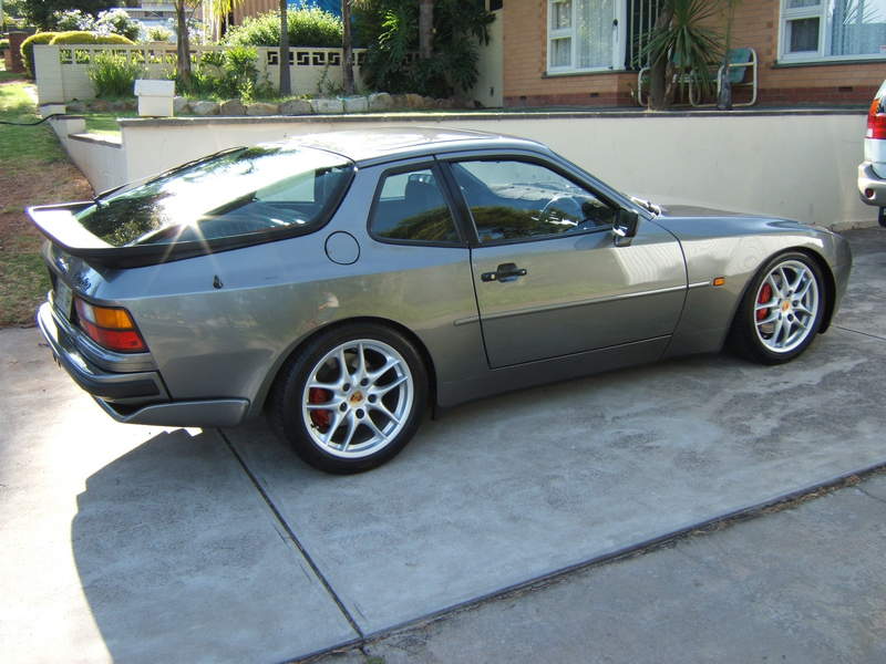

I have 17" boxster wheels on my 88 turbo they fit but the front seem to sit in out far enough (very slightly). I believe a 10mm spacer should sort it out though ??
When I bought my car, the PO had some Boxter wheels fitted. They did have spacers on them, but I couldn't tell you how wide the spacers or wheels were. Too long ago. I don't like many recent Porsche wheels but I think they look ok on this occasion.
Looking: most 7"x17" front Boxster wheels have an offset of 55mm with the rears being 50mm. These are both within 2mm-3mm of what they 'should' be, with the fronts being slightly pround and the rears being slightly inset. 7"x16" Boxster rears have an offset of 40mm, whichll make them sit about half an inch proud of the original 15" wheels on a MY87 onwards 944.
You will need to use 6mm spacers on the front wheels or they wont seat properly on the hubs.
Other than that as long as the width's are correct they will go on fine.
I think they look great....but then again having fitted them to mine I would !!
