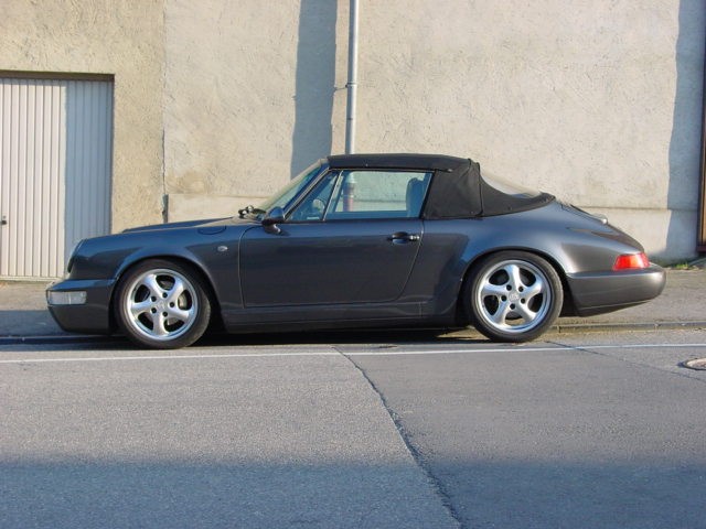

I have Boxster wheels on mine......it came with them on.
Looks good on a 964, but mine are the 17" Carrera ones (but I guess the same offset).
I just have spacers on the rear, but can't really say what size.....I'd have to check.
The car's lowered to death & there's no rubbing, so I would say they're fin (after 2 years).
