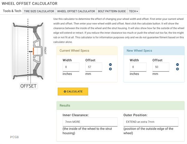

Don't do it, wheel sizes are wrong
Fronts wheels before after are okay (see above) as the wheel is the same diameter and width and would stick out by 7mm. This would be okay.
The rears are NOT suitable (in my opinion). I'll try to attach the calculations but in essence they would stick IN by 9mm but worse there would be 35mm less clearance inside the wheel arch and this is a no-no as it could well foul the suspension / brakes. Plus the car is going to look very odd with the front wheels sticking out relative to the original and the rears sticking in. In theory you could use wheel spacers to bring the rears out but I'd strongly advise against this as you'd still have wheels likely to foul the suspension
Your best solution is to look for wheels that match EXACTLY the dimensions of the standard wheels, ie 18 inch diameter 8J = 8 inches wide at front and 9J = 9 inches wide at the rear, but probably MOST IMPORTANTLY the correct offset as per Andrew's note of 57mm at the front and 43mm at the rear
Update: the wheels you have shown are for 911s not Boxsters. You might want to consider CODE: 458018081047 though thought would be needed if you wanted to keep your current tyres in particular the rears
