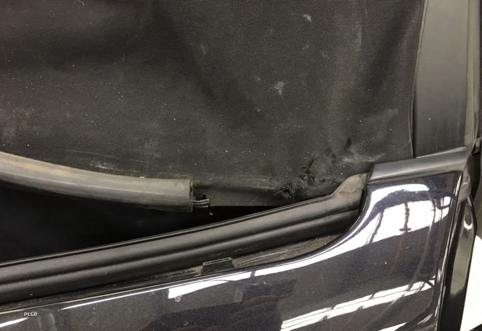

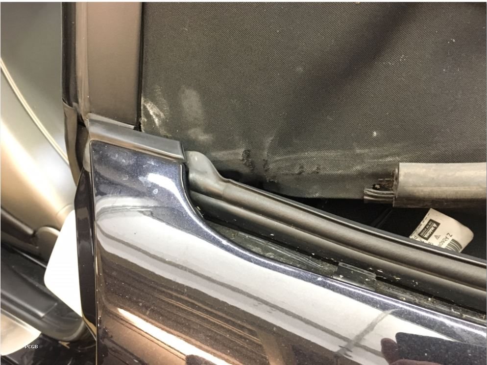

The electrics went crazy when I opened the door the windows came down after unlock ,then I opened the passenger door to try the window switch on that side as driver side would not work to my amazement the roof activating from the passenger door !! the roof struts safety plastic end mechanism snapped both sides,however I am so unlucky the drivers side strut got trapped and this has damaged my roof :( car is with OPC the roof may be able to be repaired by specialist if not then its a full 2.5K roof.
Any one had any experience of torn canvas to repair I am in Leeds area...I am total gutted as this could have been avoided by clearing out the drainage holes, to check if they are clear pour a little water down the channel of each side with a little watering can when the clam lid is up,if the water comes out efficiently at the bottom near rear tyre then its clear if not then its blocked.

Here are some pics of the damage the roof struts made ,I suppose when cleaned and roof is rested it wont seem that bad , will sort ready for summer 2017 via specialist.
