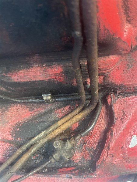

2. I have rust on the fuel lines in the rear as they come into the wheel arch area before the fuel pump. Can I clean them up or should I replace?

Sounds like its the short fuel lines that your looking at. I guess they are not too expensive to replace with originals. The 2 long lines are a pain. I think about £1000 each! however the bad news is that you need to drop the back axle to fit them...... I need to replace these on my car as the lines over the Axle were replaced by me with flexibles 10+ years ago. The flexible solutions then were not designed to withstand E10 fuel. On my last turbo I had the long lines replaced by new flexible material for the whole run that is designed to withstand E10 fuel. I know my independent had difficulty obtaining fittings. I believe he has done another 3/4 cars since then.

Unfortunately these are the long fuel lines! The good news is that the rear axle assembly is already out, so I have easy access. I did clean them up yesterday but wondering if that is just a short term fix and rather change while I have everything accessible. With the all the costs associated with refreshing the suspension and new sills being fitted, I could do without £700 on fuel lines!
Depends on how bothered you are about functionality vs originality?
I’ve just replaced my lines with PTFE/Teflon AN ones, never mind E10 I could run E85 now!
