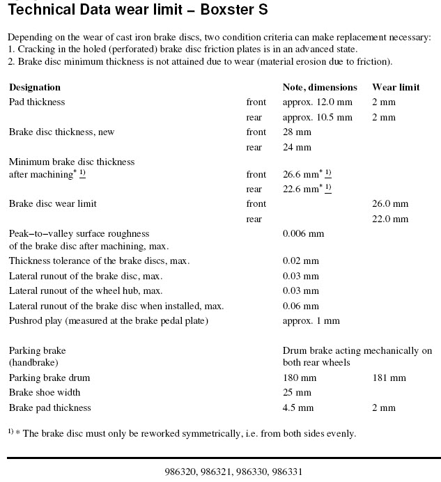

once again I come humbled to the font of all knowledge. Pads pretty much gone on the rear so need replacing. There is a "bit" of a lip on the disc so they are starting to go but not convinced they need doing yet. Could do with changing just pads this time around. Whats the minimum disc width for the rears? I got a 2001 S. Also does this vary amongst different makes of discs or are they pretty much consistent minimum thicknesses for all brands. Also, any recommendations on brake disc measuring devices?

In answer to your original question Kimo, I think that the recommended minimum disc thickness is 28mm front/24mm rear which corresponds to 2mm of wear before replacement is necessary. Also you need to check for cracks forming around the cross-drilled holes - small cracks are OK but if any cracks connect the holes, the discs are scrap.

Those are the brake disk thicknesses when new Jeff. This is what the manual says:
Thanks for correcting me Richard - I'll have to squirrel that info away for future reference.
