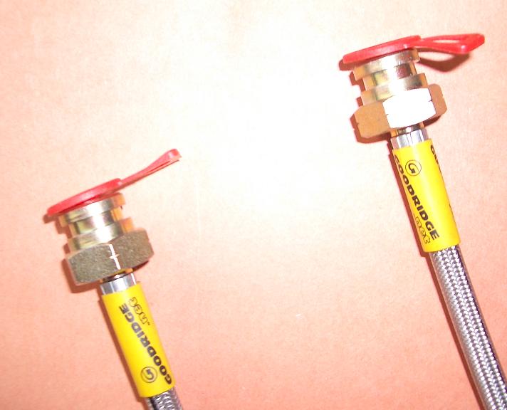

the problem i now have is the goodridge braided hoses has a much shorter union that the standard ones (about 6-7mm shorter?), so wont offer itself up to the hardpipe union on the other side of the sliding bracket?

well it must be the correct end as one is male and the other is female - i could try bending the pipe but surely it shouldnt be necessary? heres the comparison of the old one and both ends of the braided hose....

Well based upon my recollection your hard pipe looks like it is in the right position so I don't think there is an issue there so I wouldn't suggest you should consider modifying it in any way. However the female end of your braided hose looks a little different to what I remember. Are you sure you've got the right Goodrich hose set? From memory i'm sure the length of the union was longer than the one in your photo. Unfortunately my car is in with Promax getting KW'd so I can't check it out for you, however i'll try to dig up my old rubber hoses as i'm sure I didn't throw them away.

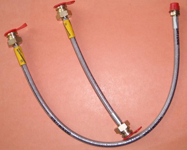

Two each of the hoses below, short one is the rear.

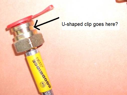

Does the u-shaped clip not go here -- I presume this leaves you with a gap between the end of the goodrich hose and the male pipe end in situ? Can you not bend it so it matches up as suggested above? If not it might mean a trip down to the factors to get a new brake pipe made up.

yup they are the same as the ones i have
but the depth of the union above the groove where the u-clip goes is far less than that of the original flexi i removed?

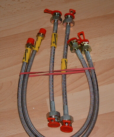

I have got a set in a bag here that have the code on. Its a paper sticky -back printer label which frankly could be stuck onto any poly bag. Not very reassuring. the No is
SPR0610-4P Porsche 944 S2
they look identical to yours front are M & F the rears F & F
