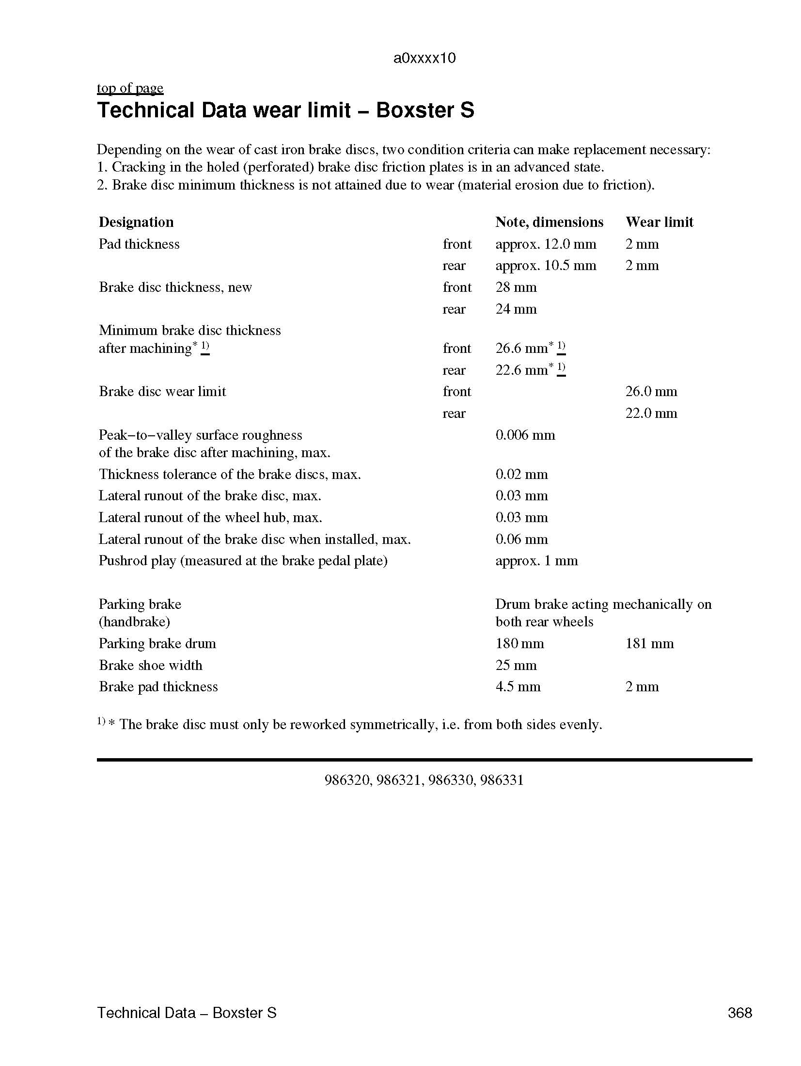

I have the image from the Boxster brakes web page showing me where to measure, but does anyone know if the 996 4S brakes are any different? Does anyone know what range of thicknesses are ok for the pads and the discs?

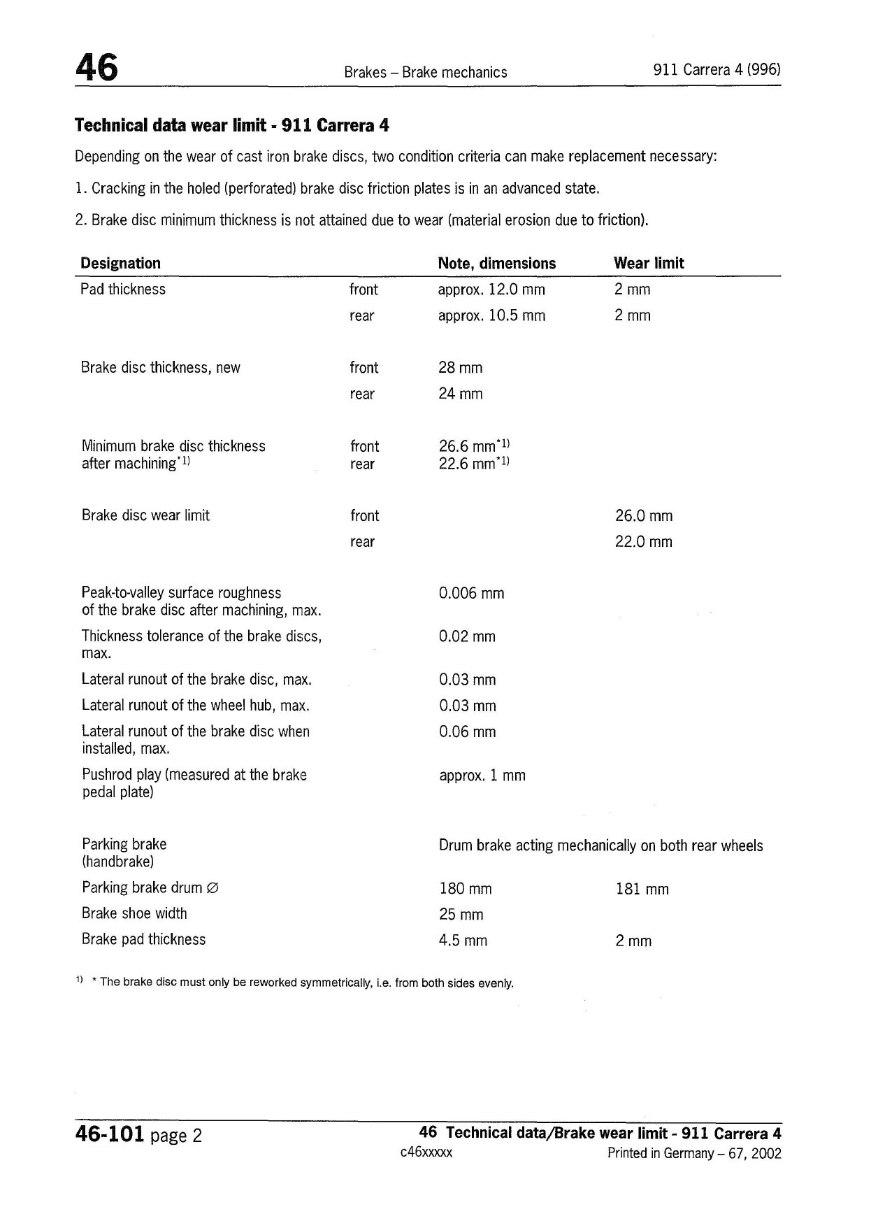

Here are the limits for the 996 C4. I hope this helps.
