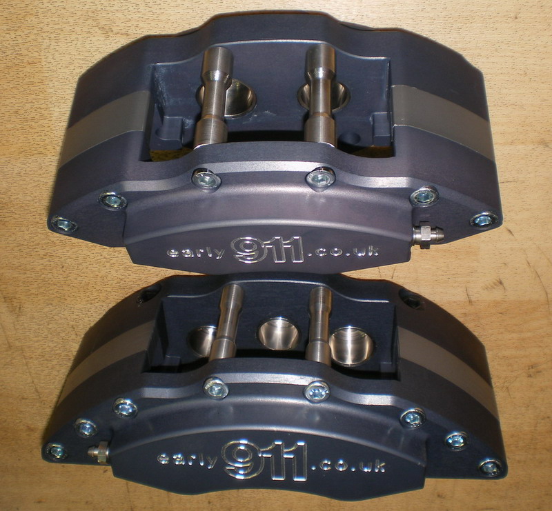

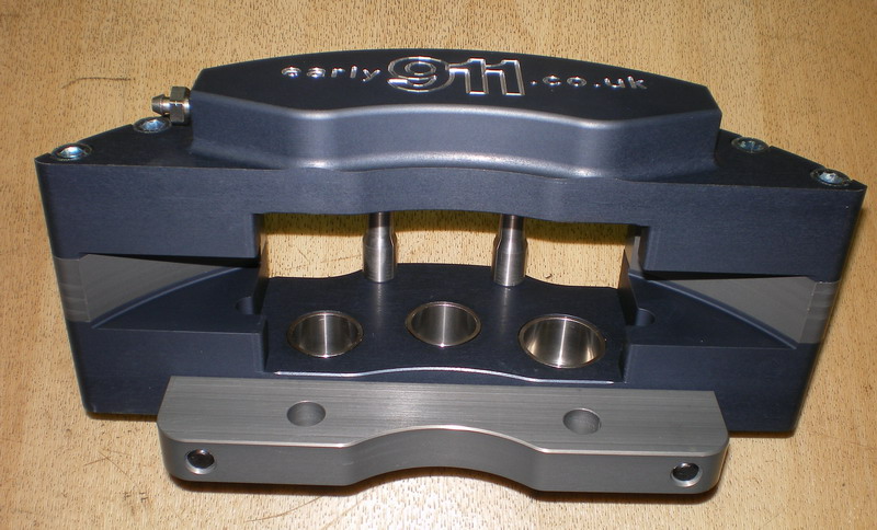

Another solution is a new set of 6 and 4 pot calipers. There can be supplied with the adaptors for 3.5" or 3" ears to save having to change your struts.

Those custom brakes look a bit good too!
