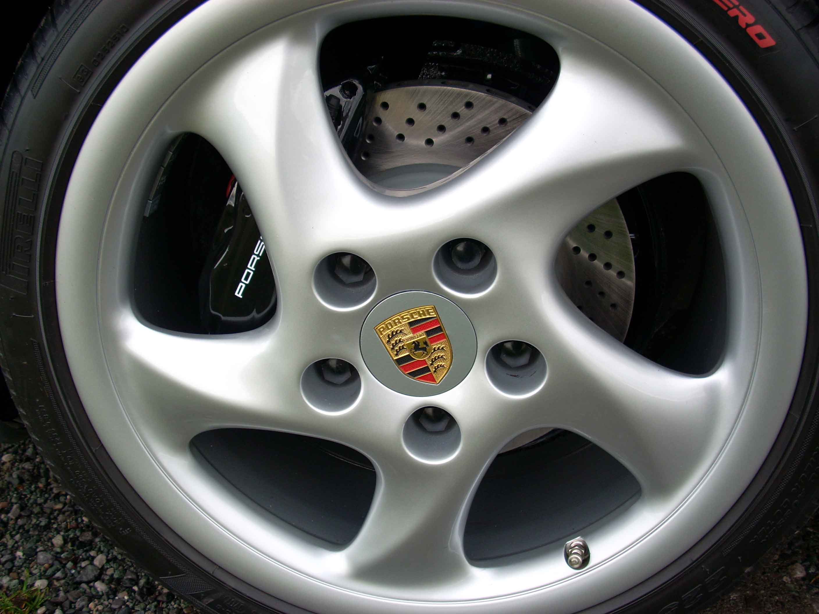

In case it helps, I thought I would share some points that I have learned after rebuilding my front brakes (rebuilt & resprayed calipers, new discs & pads).
I found that Hammerite was way too soft for calipers - had to strip them & then resprayed again with high temp engine lacquer then 2 coats of clear acrylic over the paint & new decals. They look nice now, with a good hard coating.

Brakes look lovely & work spot-on now [8D].

You are absolutely right about the temperature tolerance of engine enamel. I couldn't find spray-on gloss black very high temp paint anywhere, so this was the next best. "No problem if you want satin or matt black Sir". Yes, as you say, track work could put the adhesion of the paint under serious strain & might exceed what it was designed for. Interestingly, I had to repaint my calipers because the black paint and/or lacquer had lifted in various areas on them all. Makes you wonder what paint Porsche used. [8|]
