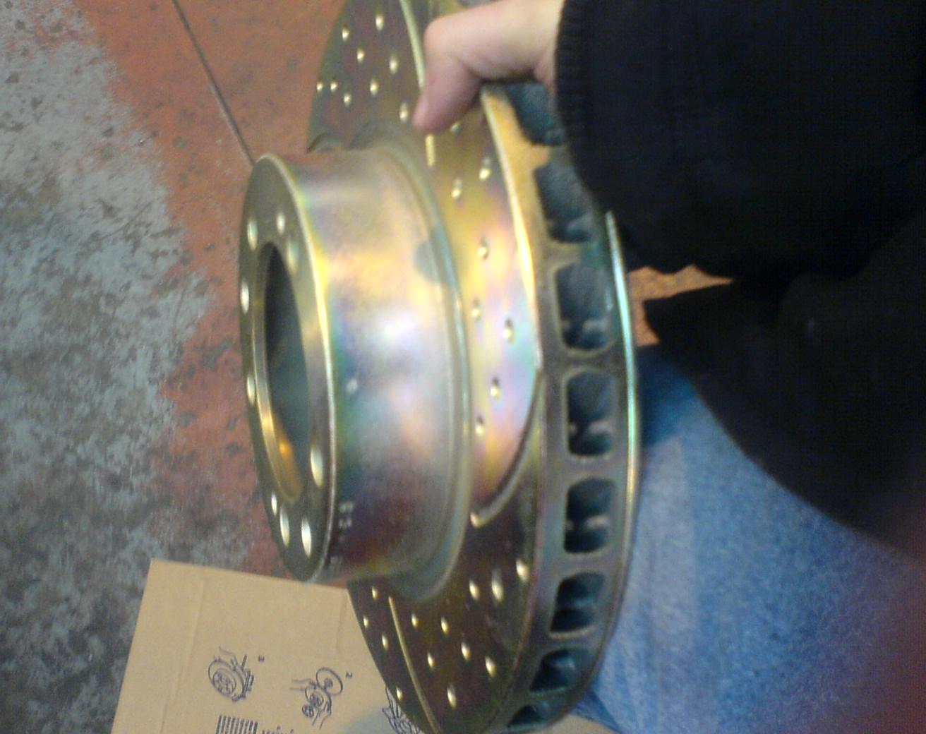

I had some with EBC disks and green stuff pads... they looked like this [:D]
