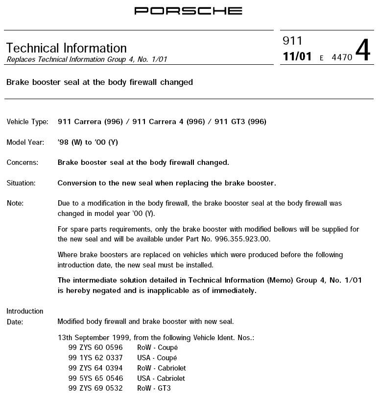

Another possibility is the brake servo. Early 996s had a problem with the bellows seal, which allowed water into the servo, causing it to rust badly inside. You would have thought that it would have manifested itself by now, but would be worth checking. If you want the full TSB, drop me an email.

If its the servo guess its easy for OPC to do without breaking the bank?
Thx Andy
