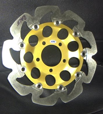

An engineering student, will know exactly how brakes work....they dissipate heat. Quicker to heat up (small, thin) = quicker to cool down. Ever seen those mega motorbikes capable of 175+ MPH ? Very very thin discs, loaded with holes..even worse...the newer brakes look more like disc cutters.
