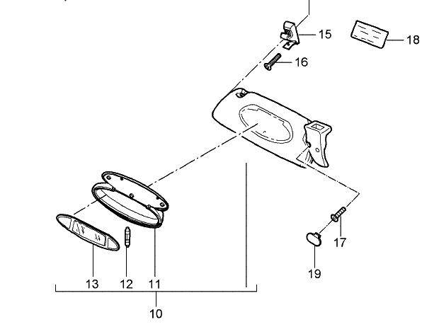

I had the same problem, I replaced the glass hinged bit and just kept the original visor shell. then replaced the middle bit, it did cost about 50 quid for it tho. ill forward a link, you also have to solder 2 wires.

Ha made me laugh, anyway heres the visor part although that's for a 1999 c2 not sure if they're different on other models. I think i just left the wires on the shell and removed them from the visor i was fitting. Im sure they get broken due to people shutting the visor without closing the flap.
There are some DIY fixes here, which might be of use: http://www.renntech.org/forums/topic/1512-sun-visor-mirror-return-springs/
The parts are available separately, but are quite expensive.

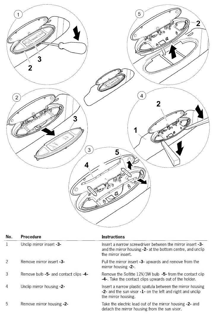

It looks like the pin itself in the mirror unit has snapped and does not look repairable.
Does the mirror unit just pop out from the visor?
