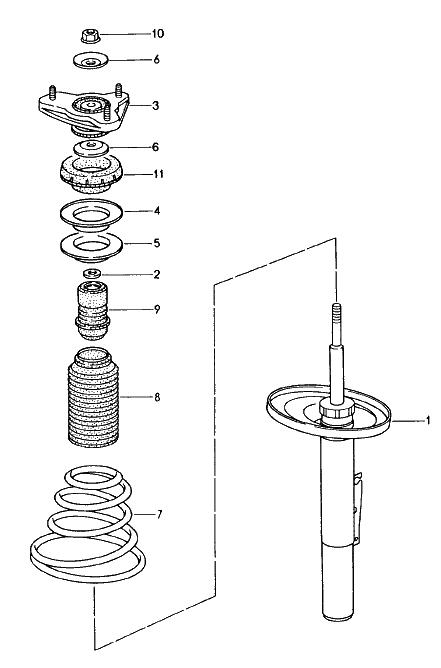

There's nothing special about bump stops beyond having the correct height, an appropriate dimension to fit inside the spring and having the correct diameter for the damper rod to fit snugly in the middle. Technically what the bump stop does is to stop the damper rod being pushed into the bottom of the tube under full compression and thus damaging the valves which control the flow of oil between the the upper & lower part of the damper.
Item 9 on the attached. Porsche call it an "Additional Spring", rather than a bump stop.
Yea i figured it would be called something differnet. Everybody seems to call the same parts different things[:D].
