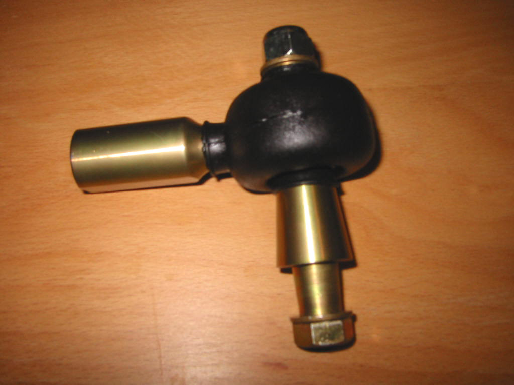

I couldnt find a UK supplier for this kit, so I ordered the ERP bump steer kit from Steve Weiner at Rensport Systems (Oregon, USA). See http://www.rennsportsystems.com/1-sh.html. He advised me to use these instead of the spacers due to the possibility of the rack binding, but to be honest the spacers have been used by a lot of people for years with no adverse issues.
He accepts Paypal so ordering and delivery were pretty quick.
As my car is almost a daily driver, I also ordered some rubber boots to protect the rod ends from John Handley Bearings.
Hope this helps.
Anil
PS. My car is lowered to 24.5in at the front and about 24in at the back.
Here's a pic of the assembled tie rod
