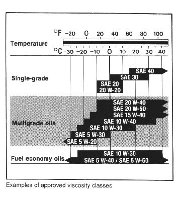

This is what's in your owner's manual. No need to go too low a viscosity. Look at what low temps even a 20w/50 operates within. How often is your car in -10c?
