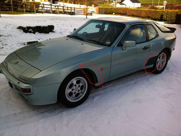

The black stick-on stuff or whatever it is behind the front arch is non-standard, as is the similar stuff ahead of the rear arch. Normally there is nothing in that position at the front, and the rear one is transparent or body-coloured. Highlighted on attached pic.
I would want to know who added those, and what's behind them. In addition to the sill rot, the arches are the other places where you typically see corrosion.
These cars are well known for being able to look very shiny and attractive while concealing a fair amount of trouble. You must inspect the sills throughly via the air vents in the B pillar - get the owner to remove them and have a good look inside with a strong torch and / or camera phone with flash.
The slotted rear valance - it's not really a splitter - was, I believe, a factory option, and there are aftermarket ones around. Have a good look to see if it looks factory-fit or has been added afterwards. If added afterwards it is another thing that could be hiding something.

ORIGINAL: Lowtimer
My 944 had clear stoneguard in that place behind the front arch. I would have expected clear on this car rather than black, but it does look a nice one
Yeah, the front stone guard is standard but should be clear too! I have them on my car.
There are 3 on each side. Behind both wheels (narrow strips) and the big one in front of the rear wheel.
Stuart
Looks like some one just got a cheap deal on a black stone chip set lol
But everything about the car seems fairly standard and in good condition, but I'd change the steering wheel, thats froma square dash car IIRC, other than that so long as everything checks out OK I'd say go for it, looks like its been well looked after from the pictures
looks to me as though the bottom half of the cill has been painted black all along its length. What sort of muppet adds black cills and stone guard, looks awful, I'd keep looking.......
