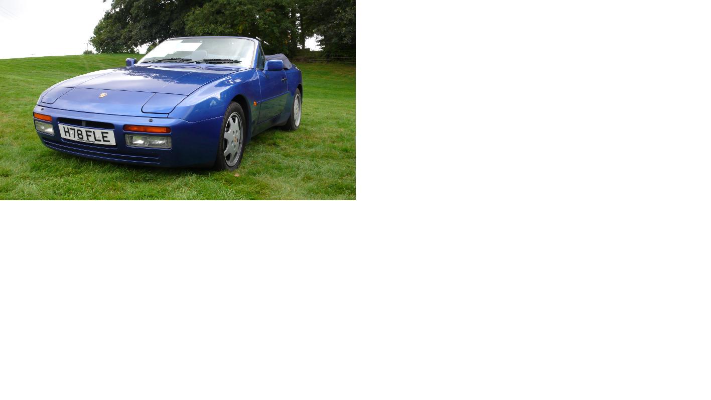

I'm selling my turbo cab:
http://www.porscheclubgbforum.com/tm.asp?m=316872&mpage=1&key=&#316872
If you are interested and want to take a look at the car or ask any questions give me a ring.
Simon

I have seen your car on piston heads, nice car but I think it will prob be a little over my budget, I will wait until my stag has sold before I go looking with a vegance, Having the cash will hopefully put me in a realistic bargaining position.
Good luck with your sale.
Mick
