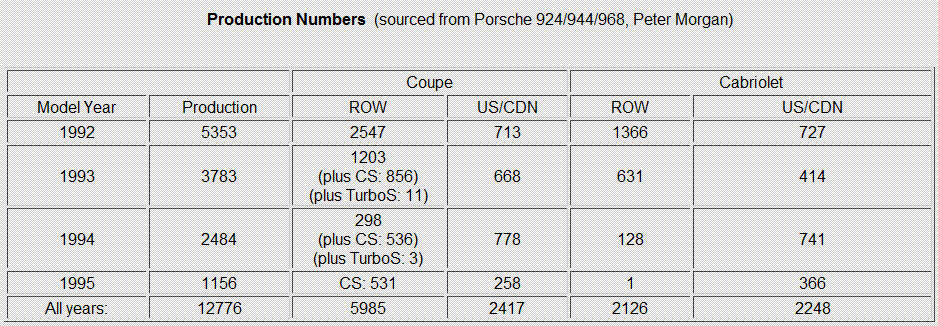

Dave S, of the 1043 968s imported into UK, do you happen to know how many of these were Coupes?
Nope. However Peter Morgans book has this table in it:
[FONT=arial, helvetica"]Dave
[FONT=verdana,geneva"]
(Hopefully a picture of a table will appear, its not in the preview....)
