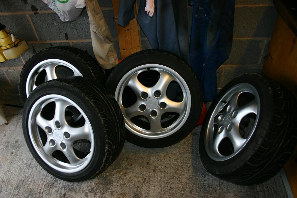

I have some Cup 1 replica's for sale - 17" with excellent tyres - correct offsets for early 944s.
PM me if interested.
Ooh - get thee behind me! Please don't photoshop them onto my car....[:)]
What are the offsets? I've not seen cup 1s on an early car?
ok details are
255/40/17 ET 15 on 9" rim with Pirelli P6000 tyres - loads of tread
215/45/17 ET23 on 71/2" rim with Avon ZZ3 -loads of tread left
I guess previous owner replaced the Pirellis as if they were like they were on my 944 they were horrific!
The 71/2" fronts are really rare and hard to get hold of and will take a 225 tyre - I have them on my RS and are the rare wheels that came on the 968CS. These are the best reps you can get made by Milli Miglia in Italy.
One wheel - top right in pic could do with a cheap refurb as its corroding where the laquer has come off in one part and is not the best.
Sensible offers accepted to recover original costs as need funds for tyres for the new RSR!
Located in Nottingham
Edited to say they should fit all pre abs cars so yes you are ok
Here is a picture. I have some more, if anyone is interested contact me and I can e-mail some bigger ones.

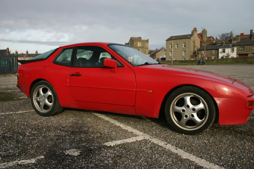

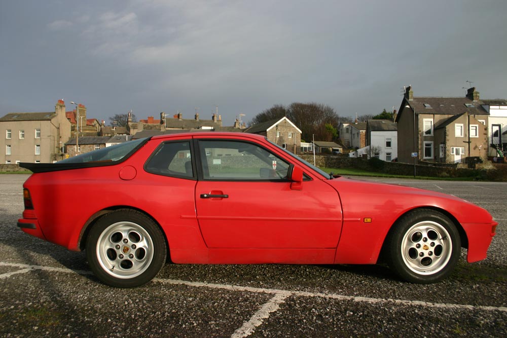

Here's a picture of early offset Mille Miglia Replicas on an 86 Lux (it's Mark Roberts who was the Assistant 944 Reg Sec about 6 years ago)
Skattrd, I'm assuming that's your car in your avatar? Why are you wanting to change your wheels? It's looks fantastic on those split-rims (3-piece cups I'm guessing?)?
