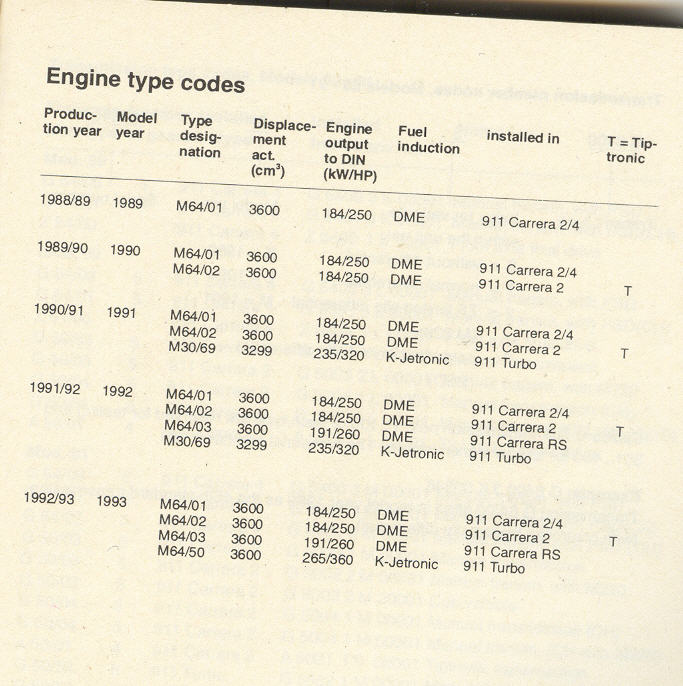

PS do you think a C4 would have less power than a C2 ?
All things being equal (the cheque is also in the post......[8|] ) yes, the power (at the crank) should be the same (unless a guru comes along to say that C4 had differant mapping), however it would not be at the wheels due to higher losses in the transmision; 2wd v 4wd.

Hope you don't think I'm bias! - but I think your measuring the power that the wrong point, therefore the loss is for the C2.
I'm talking about the 993 here (because I don't have the 964 figures), but Porsche state a slightly better 0-100km for the C4 over the C2. This is because, at the point the power matters, as it hits the road, you have more surface contact and better weight distribution. But we are only talking 0.1 sec and this is really the only point at which a C4 has any advantage!
Power figures from the C2 non RS, and C4 are the same, yes the C4 will absorb more transmission power than the C2, but the gear ratios between the two manual transmission are different to compensate for some of the transmission loss and also the extra weight etc etc . Only 5th and reverse have the same rations ....not really used on the 0-60 times ;-) .
But the official Porsche figures I have for 0-60 and 0-100 are the same for C2 (non Tiptronic and non RS) and C4 are the same ..at 5.5 and 5.7 respectively.
Mark,
Don't quite understand your first para, as at the crank power will be the same and due to transmission losses will be less at the road for the C4 :)
However, having said that and as Ian points out gearratios even things out again, and in less than ideal grip situations the baence then could tip in favour if the C4.
For the purer driving experience a C2......... runs away to hide!
