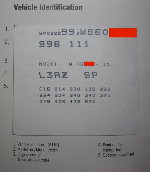

By the way Richard, how would I know if I had either of those two options?
Actually, looking at the letter of origin from Porsche, they say mine was manufactured to Cyprus specification.
And for the third edit, I have just had a look and the engine number has been removed!
HG, sounds like you have got some problems, to say the least!! The country code and option codes are shown on the VIL:
You can see the C16 for the UK, and the other options alongside. They don't always list the alarm as an option on UK cars, as it wasn't an option. It might show on a non-UK car though. There is a sticker on the top of the alarm control module, which is located under the passenger seat, and will say M534 or M535. Not easy to see though. C98 is the country code for non-specific RHD cars (Cyprus, etc). A few other RHD codes are C18 (Japan) C23 (Australia) C24 (New Zealand) C26 (South Africa). The only other "good" country code is C17, which are cars built for British personnel stationed in Germany - but I have never seen one.

Edit. The alarm code is M534, so does this mean it has got a Thatchem Cat1 alarm?
Paul - the engine number is shown in the photo - a tab at about 45°. Because of its position (exposure to the elements) it tends to be very difficult to read. That's the only place the engine is stamped with the number.
If the alarm control module is M534 it is the same as UK spec, but I'm sure it won't have the siren and tilt sensor, so it won't be Thatcham Cat 1. Depending on what your plans are for the car, it might be worth finding out from Porsche if they would be able to certify it if these items were retrofitted. How easy that is depends on the loom of the car. If there are a couple of empty electrical connectors to the right of the battery, then it might be a simple job.
