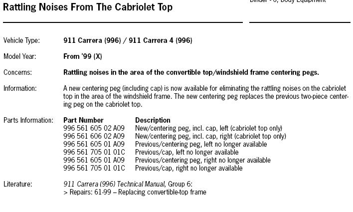

Could anyone explain why the cap that fits on the end of the "centring journal" on the cabriolet hood should have jumped from £0.39 (996 561 706 01) to £23.34 (996 561 606 02)? I'm missing the RHS cap (705 and 605 relate to the LHS cap) and was rather disappointed with the price change for the superseded part no.

In my parts list 996.561.606.01 was £14.21 (706.01 doesn't exist), so not quite as huge an increase.

I remembered the attached TSB which explains why the change was made, and forwarded it to Matthew. I thought it would be worth adding here in case someone finds this thread in the future.
