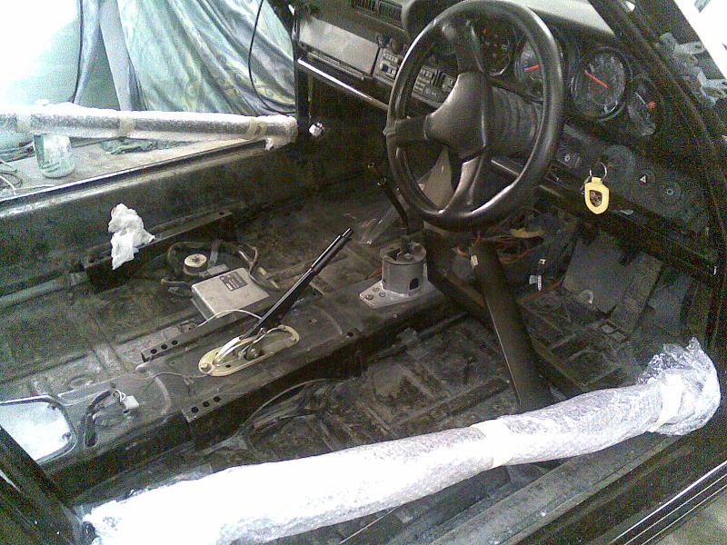

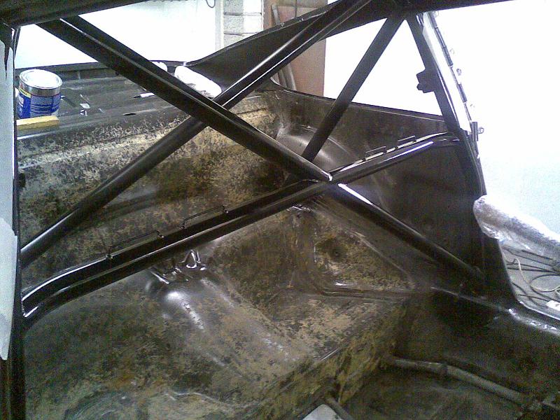

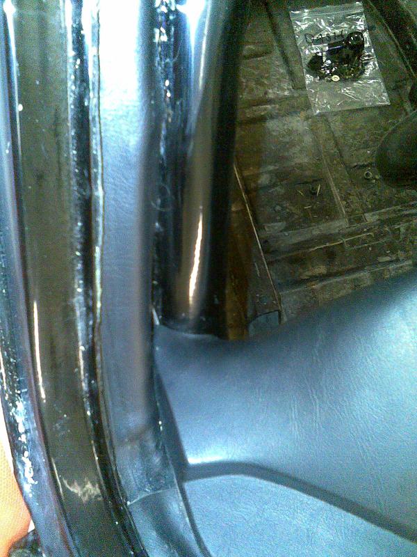

Hi,
In my opnion the only way to get rigidity and safety into a 911 is to fit a weld in cage. The best i have seen to date are done by Tony at GTR Motorsport. They cost around £2000 painted an fitted.
I have just had one fitted to my 3.2 Carrera track dy shed.
Please in the attached pictures to see what I mean. Please note the careful, cutting of the dashtop to fit the new cage.
Kind regards Ian
Ian
Thanks for all of these pictures. The cage looks like a really nice job.
I am probably going to get him to do mine. Did you take out all of the trim, or did he? Did it all go back in okay?
Also, I have been on his website, but there is no phone number. Do you have one?
David
Hi DavidM777,
The price of around £2000 includes complete removal of the interior prior to cage manufacture and fitting. The cage is partly painted, in a colour of your choice, outside the car is the welded in and then painted once again. The interior trim like the dash top, knee pads and the carpet is trimmed to fit the new cage. the triming also includes cutting of the a and b piller vinyl pieces that go up to the roof lining.
The attention to detail is fantastic.
I am fitting a 3.2 Carrera club sport carpet set. I willa dd a picture when is is completed later this week.
Call Tony on 07980 874690 and please mention where you get my name from.
Tony can also do the same style of cage for a car with a sunroof! I have replaced my sunroof roof with a plain new roof as this saves16Kgs
Kind regards Ian
