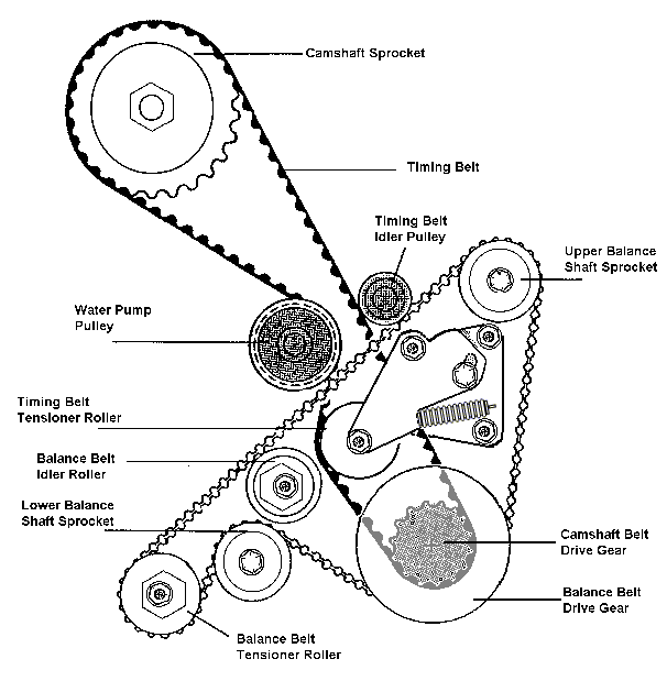

Hi All, I've just replaced the cam belt and balancer belt, along with 5 rollers. The original belts were really loose and even the arm on the tension had siezed and some of the rollers sounded well worn. My problem is and if I refer to Clarks Garage drawing Eng 10 Cam shaft (timing) belt and Balancer Shaft Belt tension drawing hopefully attached, there is a balance belt tensioner roller and a balance belt idler roller, both lower left. The tensioner roller I removed did not have any spockets that i can remember and is just a plain roller, were the idler roller removed has spockets, is this correct ?
I took off the rolllers and lined them up so I replaced them in the same order as removed, but now I'm wondering if I've made a mistake! as I'm now trying to tension the belt I have two spockets really close to each other, remember my balance belt idler roller is a sprocket - is this correct ? or should it be a plain idler roller similar to the timing belt idler pully and then the balance belt tension roller be a sprocket?

Hi Gary,
The Balance Belt Tensioner Roller has teeth, the Balance Belt Idler Roller is smooth.
HTH,
Jim.
Hi Jim, Thanks for the confirmation, must of been getting tired last night and put them on the wrong way around, didn't think it looked right.
