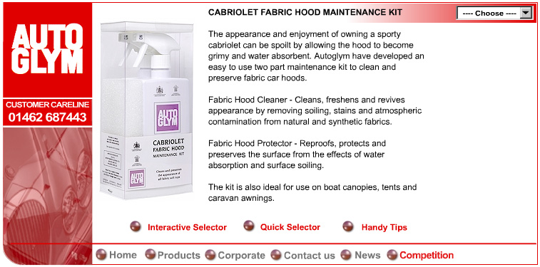

I'd suggest avoiding the Autoglym hood kit...expensive and not that effective.

Julian - I used the Autoglym Cabriolet Fabric Hood Maintenabce Kit. It took me a while but I was well pleased with the results.
http://www.autoglym.com[/i]
R.[/i]
