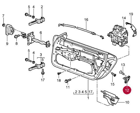

It sounds like the door isn't closing fully, and the latch isn't closing the microswitch contacts to tell the system the door is closed. I would think it just needs an adjustment of the striker plate on the door shut. Or maybe they didn't get the door card back on properly, and it is stopping the door from closing.
Hi Richard,
Where is the striker plate located? - Anything I can do to try and resolve this? ;)
Door-card looks like its on fine - but will double check!
Thanks very much for your response!
Sam
Item 12 on the attached. It is screwed to the door shut - you can't miss it. The door lock engages in the loop on the striker plate. Use a fine tip 'permanent' pen to mark the current position of the plate. Loosen the screws, and move the plate about 1mm to the outside of the car. Tighten the screws, and try it. Adjust it so that you have to close the door firmly for it to shut, but not have to slam it.

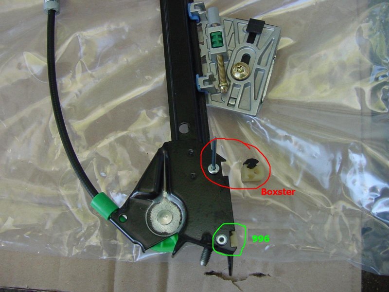

My passenger side window goes all the way down so it can't be seen... When the drivers side is put right down there is aout two inches of glass showing!
Any ideas why - presumably needs mechanism tweaking? If so how?
Someone has fitted a Boxster window regulator to your car. They are essentially the same, but the bottom stops are in a different position:
