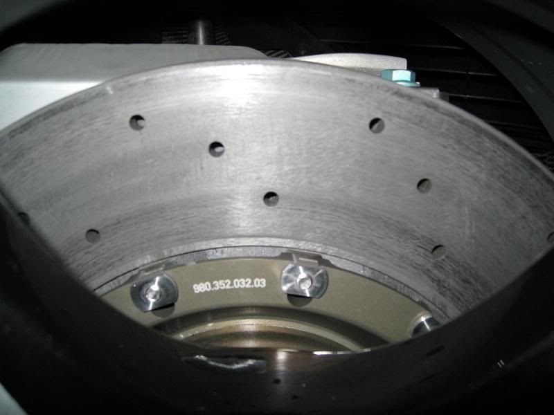

After around 15k miles on my Carrera GT and probably 20 track days the front rotors were in the first stages of 'Carbon Burn'. This is where the outer laminated friction surface has started to break away from the body of the disc itself. I've had various converations with SGL Carbon and they have confirmed the rotors are still absolutely fine to use, but the heat generated by prolonged track use has started the delamination process.
I had a set of cast iron rotors and bespoke bells manufactured by Brembo as a temporary solution. The impact on the CGT's handling and steering was huge and I knew I had to find a light weight disc solution without the inherent issues of the SGL Carbon rotors.

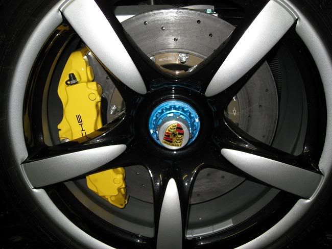

After lengthy discussions with Surface Transforms and Movit (who are the agent for System ST Brakes) I elected to have a set of rotors manufactured, with cross drilling that could be fitted to the existing SGL bells.
I've attached a couple of pictures of the rotors fitted to the car, I've not had a chance to bed them in yet but have no doubt of their ability to offer equal performance and weight benefits to the SGL Carbon solution, whilst offering hugely increased durability and strength. (I have however had a previous version of the System ST discs fitted without cross drilling, on bespoke bells and they performed superbly).

Good post. I see they have started drilling the rotors now, I remember a year or so ago they mentioned it wasnt worth/prohibitively expensive to drill holes in them. I guess they've got a new version out. Do you know how much your disks weigh? Are they good from cold or do they need warming up before you get good bite out of them? Do they still require about 1k to bed in? Are they the same price?
Hi Rodney
The drilling on mine was done after the discs are produced, which did add cost but I wanted to retain the OE look and also have the benefits of the cross drilling. I'd have to check my records to confirm the cost.
As for weight the solid, i.e non-cross drilled ST rotors on the previous custom Movit hats were 5.10kg. I would expect the cross drilled discs (with slightly less mass) on the SGL carbon hats to be around 5.00kg, the same as the PCCB's.
The solid discs I previously had fitted took around 1000 miles to bed in, although I was running a very hard Movit pad. These discs have covered 20-30 miles and I'm running the OE Pagid for PCCB's and they are already starting to bed in (when the surface of the disc looks 'glassy' the discs have bedded in). You can see on the larger pictures the outer and inner edge of the disc looks shinier than the rest of the surface.
As for price as my latest cross drilled discs were exchanged for my previous solid discs I'm not sure on current cost. Probably best to talk to Guido at Movit on this subject.
