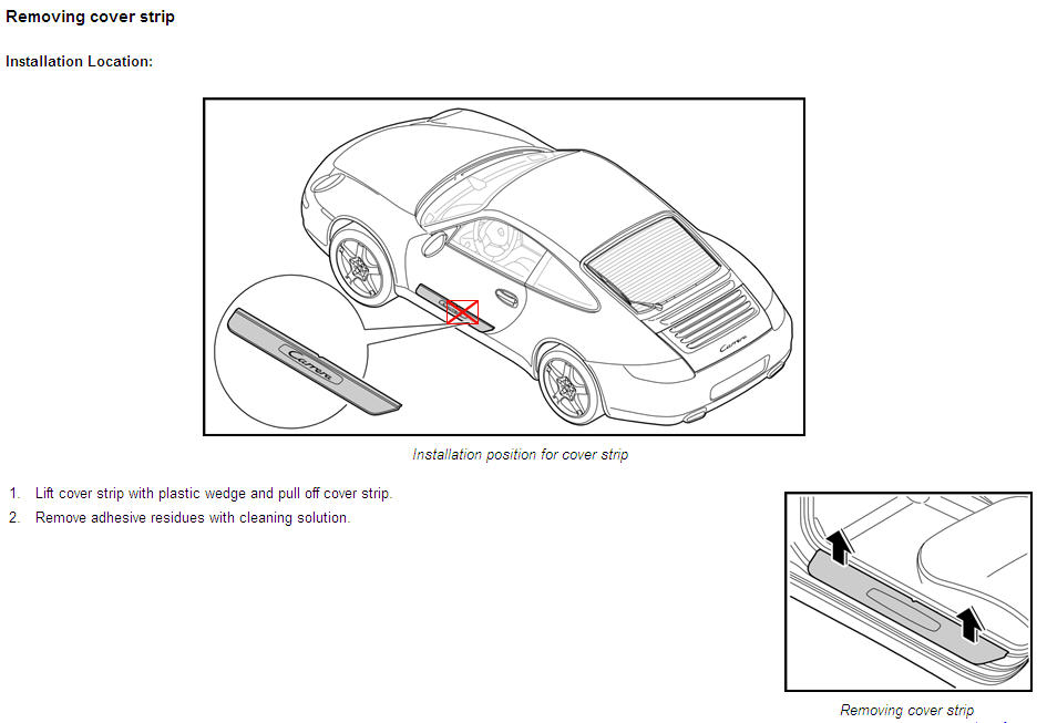

It is supposed to be as easy as they told you:

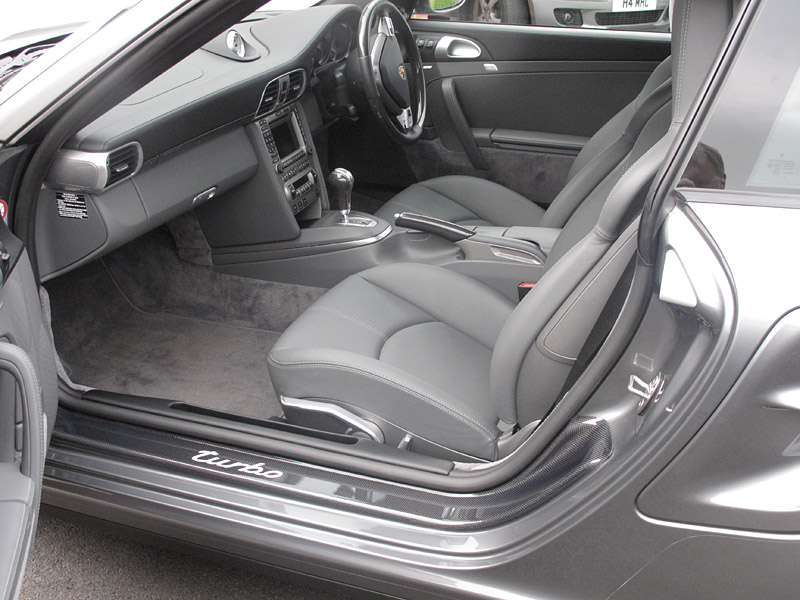

All done, found it hard to pull the first one off, used hair dryer to warm the adhesive up then used plastic tyre levers to give it a start, had to wear thin gloves as I just couldn't get enough grip with my bare hands.
OPC wanted £99 plus VAT to fit them, it took me an hour .
