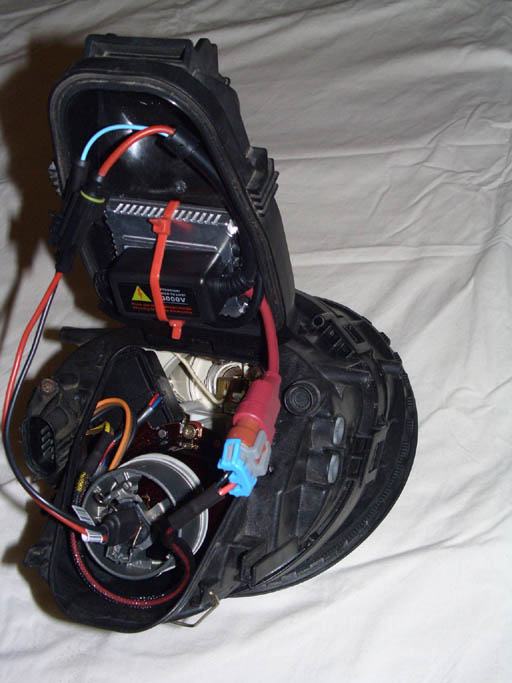

I have these units, and I have had to take the ballasts out once in order to change the direction when I drove to the Nurburgring. It was a pain in the @rse to get the ballasts and the rest of the gubbins back in, but it gave me something to do on the ferry! It was a picture watching me and my mate sitting in the bar with a headlight unit each, both of us cursing the fact that it "almost" went in! [:mad:]
The other issue is that the headlamp levellers no longer work. Not that I use them anyway.[8|]
Hi Guys,

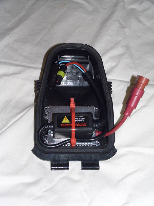

Provided the HID ballast and control units do not foul the back of the reflector, and the light unit's electrical connectors are good, the levellers should work. It's best to place the components at the bottom of the back cover. The picture below shows this. The metal box part is bolted to the casing, and the plastic unit held in place by a cable tie around this, there is also a double sided sticky pad between the two units.

Took car out last night to see the difference and have discovered that both beam adjuster have packed up - even though I can hear each motor trying to do the job. I suspect that the housing is too full of wiring and connectors....

First question. When siting the ballast in the cover I noticed that some pictures show the bottom 'lugs' in the cover sawn off or removed somehow which gets the ballast as low as it can go. I want to avoid this action so does it work with the ballast above these lugs (not sure what else to call them!)
second question. In the back of the headlight there is a yellow and brown wire, yellow into bulb, brown into light surround. Do I simply remove these and plug them into the red and black spade connectors that come with the new units? This is the part I am most unclear on....
