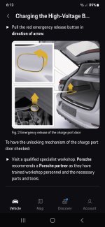

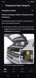

The MY 2024 owners manual has instructions to open the flap in event of the unlocking mechanism failing .. I assume your MY has similar instuctions .. have a play around and see if something is jammed / visibly wrong ??

Thanks for the replies. Mine is a 2016 model and doesn't have the same access panel in the boot. See attached photo. No obvious easy access. I think that grill is for a speaker in the boot, but again not easy access. Probably something to just live with, but I may get it checked out at some point...20250412_105909.JPG
