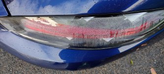

One of the images below my Cayman when it suffered very badly with this issue. Note the condensation turning into large droplets and running down the inside of the lens. I took the car to my local OPC, got the service manager outside so he could view the problem and photograph it. It was immediately accepted as a warranty case. This was on the nearside (image wrongly labelled).

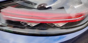

New rear light duly installed (later part number) on the nearside. Result - condensation significantly reduced but not eliminated. See the image for the offside light. Note that this was photographed following a 2 hour drive so strictly speaking I should take it back!!

Great pics and the second one is exactly what I'd say was normal - a light misting which clears over time.
The first was definitely in need of a claim so I'm glad to hear you got sorted.
No car is perfect, so I'd say 3 claims paid out in 5 months, while an inconvenience of course, is good in that things are being fixed?
As Twinfan says, misting is normal, but water droplets are a claim.

Thanks for the copy of the technical document. Looking at this I need to challenge my OPC’s rating (they’ve rated it as 2 maybe 3). Photo shows a recent incidence. It does clear eventually. On this occasion it took two days. IMG_4325.jpeg
Thats pretty bad - I'd say its maybe even qulaify as a 4.
