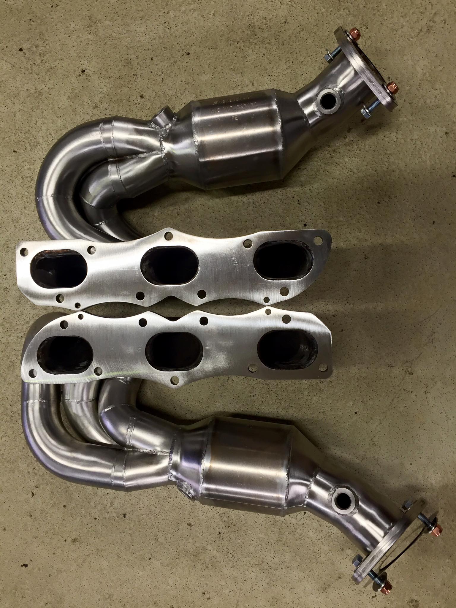

I see jens is not going to use cargraphics manifolds now and has designed his own, looking forward to the results. And I hope Cobb will make not having to spend £5k on a new ECU bring the price down for a 420BHp Gt4.

BTW on Jens's new header. He has used M&M for a couple of years and has gone through several versions on his modified Boxster, so he's doing a deal with them to help them reach a larger market.
