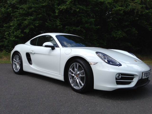

Hi,
Picked up my new Cayman PDK yesterday and it looked stunning. My first Porsche after many years with Audi. Really happy with the choices I made and the finish on the car but after a few miles noticed a rattle from the rear somewhere [:(]!! Surprised that this could happen on a car of this quality I assumed it was something in the boot but it appears to be coming from the interior plastic trim around the Tailgate. Its now booked in for investigation.
Has anyone else noticed or cured anything like this ??
Craig

Craig & Jeff, No problem with tail gate, or any other rattles on mine. Good colour choice, mine is white. Chris
