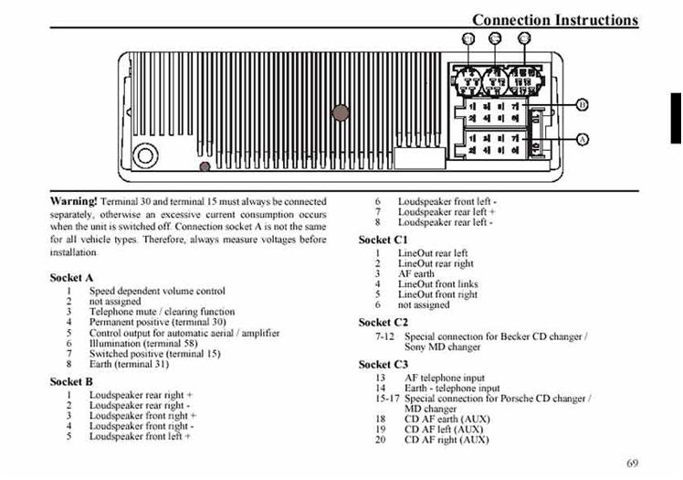

However as I took the radio out, the connections for the CD changer wires disconnected themselves - one red and one white wire, which were attached to the C2 part of the attached diagram and presumably provide power to the CD changer.
Car is a 2004 986S, radio is CDR23
Could anyone tell me which pins they should be connected to please?
