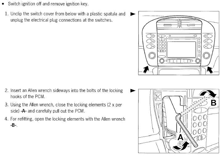

Have tried the 1-4-8 re-set twice this morning with no effect. PCM2 ON - pressed 1-4-8 buttons together - system goes off, comes on again then goes off again. Turn system back on and same message appears on screen - 'System Error: CD Multi-changer not available'. Have tried re-inserting cartridge several times to no effect. Car kept in garage and damp/condensation not usually a problem - even in winter. I suppose it is possible that a connector has come loose from the rear of the PCM unit, although as the changer has power, which I assume it gets from the PCM Unit as part of its connections, this does not seem that likely. However how easy is it to removed the PCM unit to check. I have tried taking of the surrounding trim to reveal 4 small screws in the supporting plastic frame. Removing these did not allow that area of plastic to come out and the PCM seemed as fixed solid as ever. Are special tools needed etc - is/are there any tech' diagrams that would help?
It will also give you that message if there is a break in the fibre-optic loop. Check the orange cables are secure on the CD changer.
If you have to get it out - unclip the horseshoe and look at the sides of the PCM unit. You will see a hexagon fastner at the top and bottom on each side. These are 1/4 turn fastners, and turned with an allen key or ball driver:
