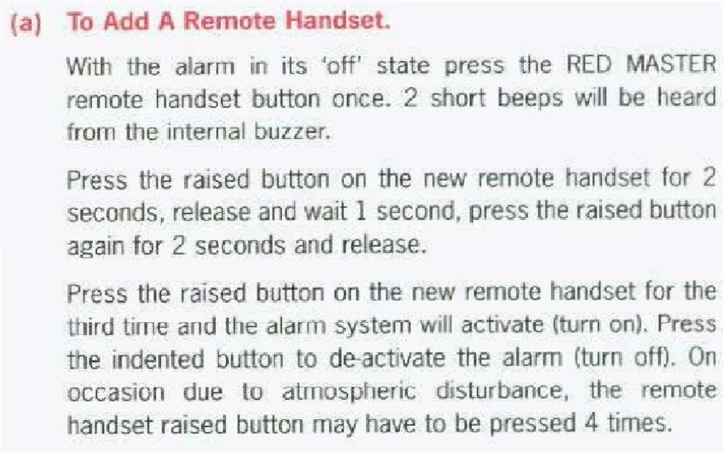

He suggested I try using the red master key inside the car (battery installed) followed by the standard fob 3 or four times
Sadly this did nothing

Did you follow the procedure for the red master unit or just press it? If not done might be worth going through the procedure that re-links black fobs with the alarm - but it sounds like your fob is being recognised - you said you get a dashboard full of warning lights - so must be recognised. Really a dashboard full? Normally I just get the hazards giving a flash.
