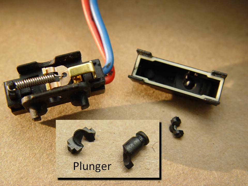

It sounds like one of the microswitches within the door lock assembly is stuck or broken. It is a fairly common fault. You can't buy the lock switches by themselves, and have to replace the complete lock assembly, at a cost of about £100. Of course, it is difficult to tell which side is causing the problem without doing a diagnostic check.....
Brilliant tip re the emergency locking routine, tks. I'll try and find the micro-switch in each door and test them.
You'll have to take off the trim panels to remove the door lock assemblies. Once you get them out, you can take them to pieces, and you may find the broken switch. I have heard of people replacing them with a similar item from Maplins.
