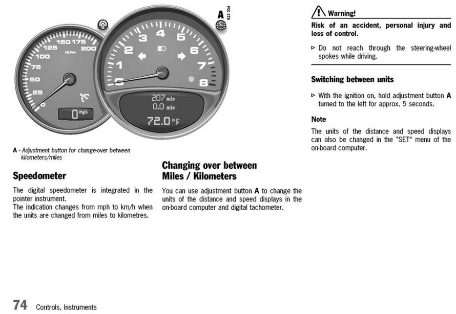

Just for those that didn't know this like me,
which would have been nice to know when we were driving abroad at the end of last year[:mad:]
You can change the digital miles per hour to kilometers by turning and holding the knob used to adjust the clock to the left. This will also change the digital odometer and trip odometer.
I keep a sticker on the sun visor with information about how to change from mph to km/h and vice versa, zeroing the odometer, etc.
