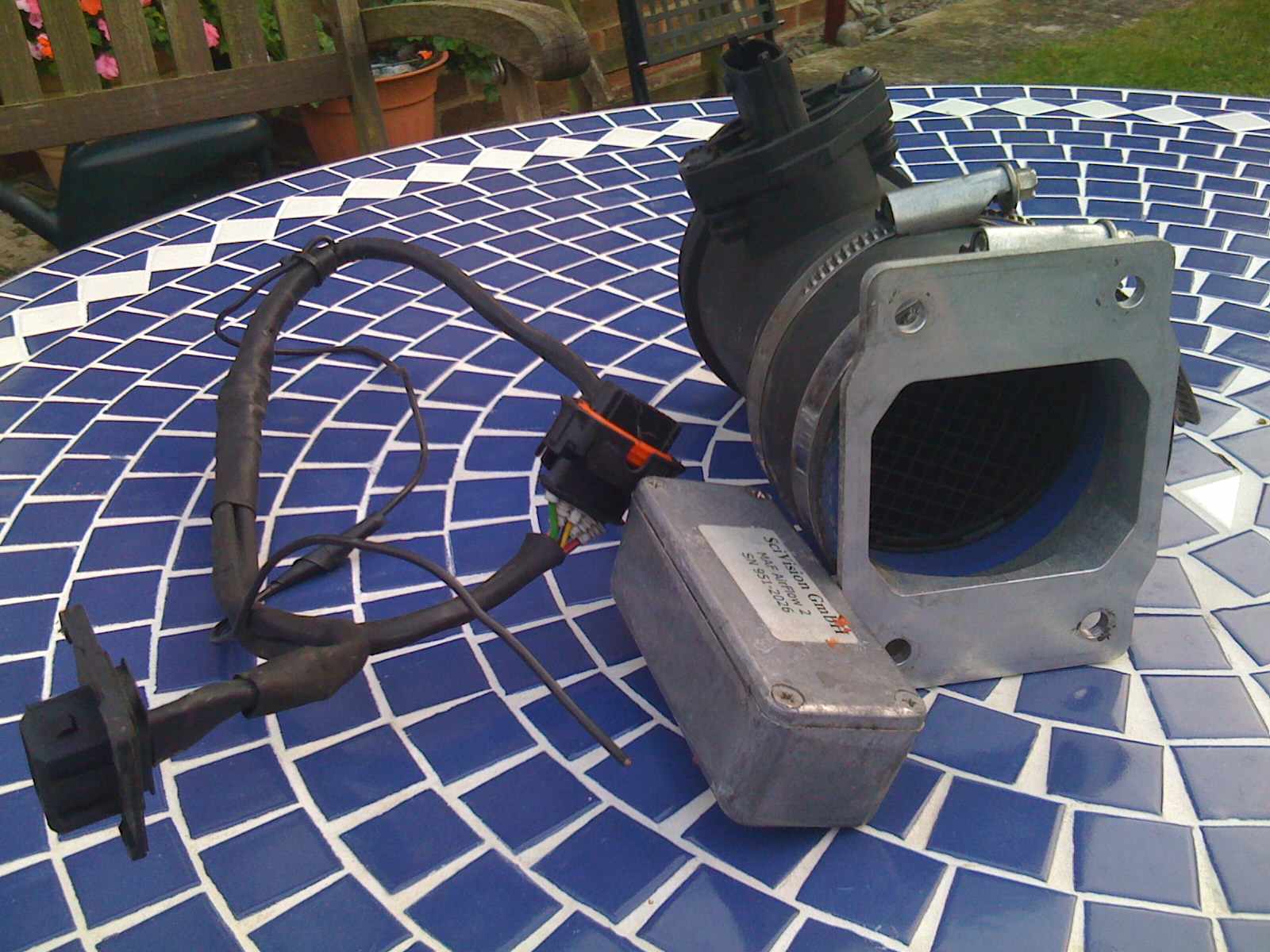

I have a scivision MAF from my 944 turbo for sale if you're interested. I'm looking for £400.

I thought the SciVision was not a true maf and the Vitesse one was the only one on the market that was?
The Scivision is a Bosch MAF meter with an electrical convertor that generates a signal that can be read by the standard ECU, which is why it's an easy plug and play. The Vitesse requires a a piggyback arrangement to work (or stand alone ECU) but has the benefit that it exactly measures airflow from min to max whereas the standard/Scivision arrangement maxes out at a certain point meaning that you're relying on calculated and not measured flow. That's my recollection anyway, but I'm sure someone will correct me if I'm wrong.
My research on this subject lead me to the conclusion that for a turbo i'd have said Vitesse MAF but for an N/A car I don't think that there is a point going for a Vitesse kit. The Vitesse kit is a true MAF setup whereas the Scivision is more of a AFM to MAF conversion in that the ECU still see's an AFM signal converted from the MAF output which means you are not getting 100% of the benefits of a MAF. This is probably all academic in an N/A car where good mapping will dial out this effect - however in a turbo then the real benefits of the Vitesse MAF will be beneficial. For example with a Vitesse setup you can vary boost however you like and the system will accommodate and maintain AFR's. With the Scivision you cannot as it is mapped for a specific boost pressure and if you change boost you'll be either under or over-fuelling. Also with the Vitesse V-Flex kit you can control boost pressure and map ignition against boost pressure, which you can't with the Scivision kit.
