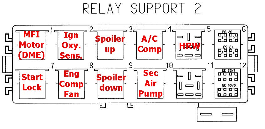

After about 10 minutes, try pulling Relay 2 out of the relay board under the carpet panel behind the rear seats. The oxygen sensor heaters are held energised for a few minutes after the ignition is switched off, which causes quite a hefty drain. After doing that, I would try leaving it until 35 minutes have elapsed, and start pulling fuses one at a time, to see if one has the effect of dropping the current to a sensible level.
Thanks for this Richard. I need to have some coherent plan of action here. Presumably, you'd normally expect some system(s) to cut out after 30 minutes? I presume that's why you suggested the 31 minute check? But you're suggesting checking the oxygen sensor heaters after 10 minutes. I'm confused. I have to say that my inclination is to take the car to the garage again (this isn't a Porsche main dealer - just a normal garage that handles Porsches, and therefore reasonably priced). At least I can now tell them that I've measured a battery drain that's far too high, and get them to track down the problem. Don't get me wrong - I'm very grateful for your advice, but given the likelihood of having to replace an expensive component anyway, and of my being unable to arrive at a conclusive diagnosis myself, I might as well hand the problem over straight away.
Ed

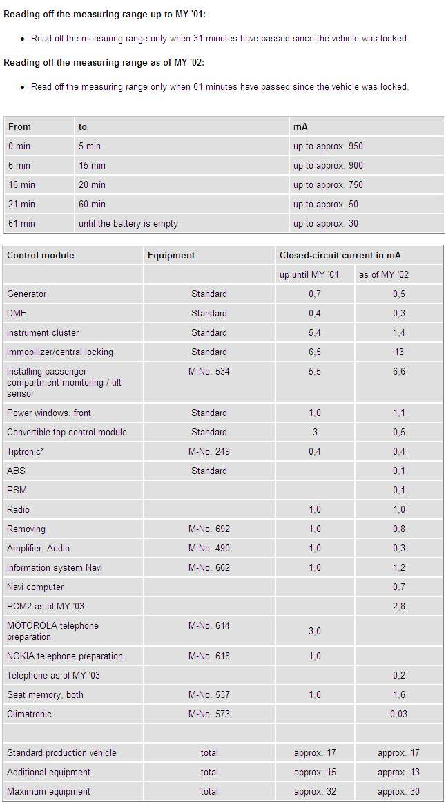

This is the load drain table from the manual, so you can see what each system draws, and the times at which the current drops. Bear in mind that on -01 cars, it should all stop draining after 31 minutes.
Thanks again Richard. However, I'm further confused. I followed your directions to the letter earlier - I turned on the ignition and then turned it off, but left the key in the ignition. However, I notice that on your attachment, it says 'Read off the measuring range only when 31 minutes have passed since the vehicle was locked'. I never locked the car! Does this mean my test yesterday was invalid? Maybe the drain is always that high as long as the key is in, and car is unlocked? Should I repeat the test with it locked?
Ed
I don't think it will make a great deal of difference, but you could try it with the car locked. If the meter is not already in circuit, you will need to leave the key in the ignition while you put the meter in place, and then remove the key and lock the car. I would leave the window down, so you can lean in to remove the key, and activate the boot catch with a screwdriver before locking it with the boot open.
Thanks again. I've repeated the test with the key out and the door locked. This time the initial battery drain after a few seconds was around 130mA, but this had decreased, by the half hour stage, to only 40mA. So, contrary to my first conclusion, I now reckon that's OK. I now suspect that I have a duff battery - it's fine in the milder weather we're having at the moment, but it seems to give up very easily in the very cold conditions we had a couple of weeks ago. I guess the best plan, in that case, short of replacing what is a relatively new battery, would be just to disconnect it altogether if there's another very cold snap and not use the car for that time.
Ed
40mA is normal, so I'm sorry for sending you on a wild goose chase!
